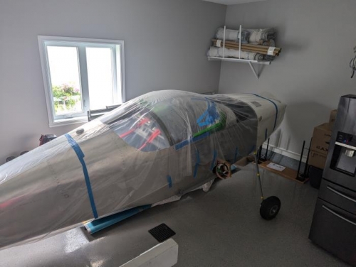

NB: The shop space is now 30 X 34 compare of the working space 2 years age which was 11 X 22. It makes a huge difference specially that I can work on the wings while the RV6 is sitting right next to it !
