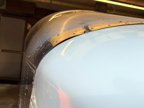

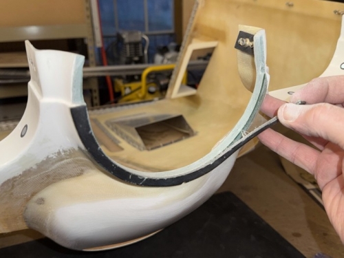

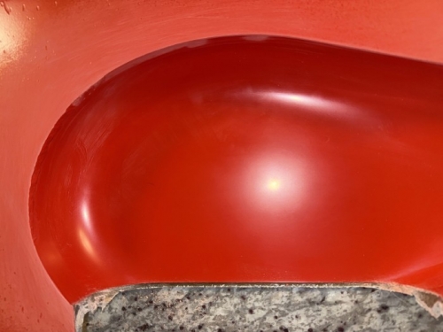

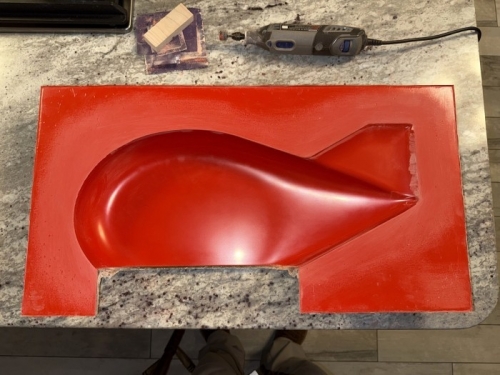

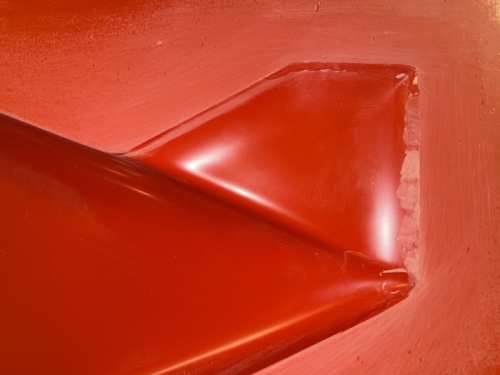

First steps for final mounting were typical #40 drilling and clecoing, followed by updrilling to #30 bit size. All prep for final riveting was completed on the holes and the aluminum frame, and final rivets were installed.
The entire cowling gelcoat was a bit on the thin side in my opinion, and it showed here with the holes in the gelcoat experiencing some minor cracking and chipping. The access panel is perfectly functional for now, but for judging level appearance for later, the gelcoat will need some touch ups at a later date.
All said and done, I'm happy with the appearance.
Cleco attachment of the aluminum from to the cowling's underneath surface.

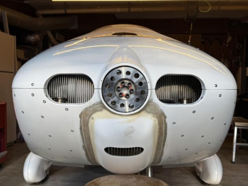

Full cowling view of the final access panel mounting.
View showing the inside area and the bottom of the door panel.
