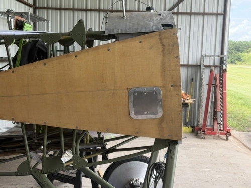

Short Description:  Side Panel Access Door R/H Side
This access door as the door on the L/H side were both purchased commercially and hung hinged from the top. The door frames were atatched with 3/16" rivets and secured with aluminum washers on the back side if the plywood
