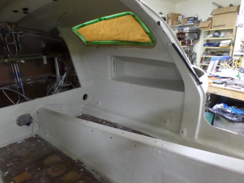

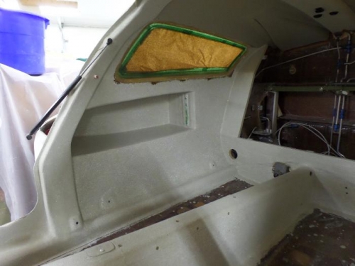

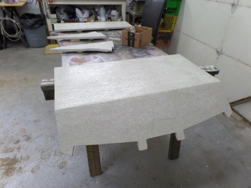

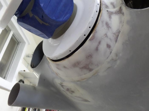

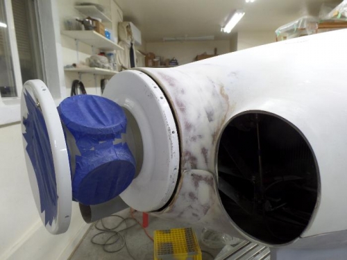

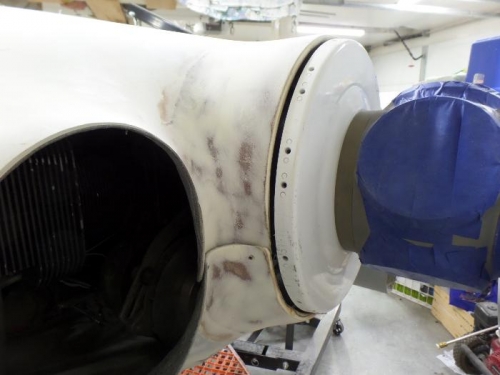

Short Description:  I removed the peel-ply and applied Alpha poxy with
I removed the peel-ply and applied Alpha poxy with micro balloons mixed in and this is a sand able mixture. I find that the best sand able mixture is when in hangs off the mixing stick and doesn’t move, if to wet it is very hard to sand because there is to much wet resin in the mixture. I had one spot were the lay-up had lifted and this was cut out and a patch installed, later when curd it was sanded and filled one more time. The cowling is ready for primer and pin hole chasseing.
Time to prime this thing.
Just need to install bind nuts
All patch and now prime
