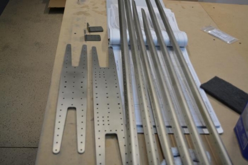

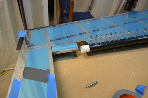

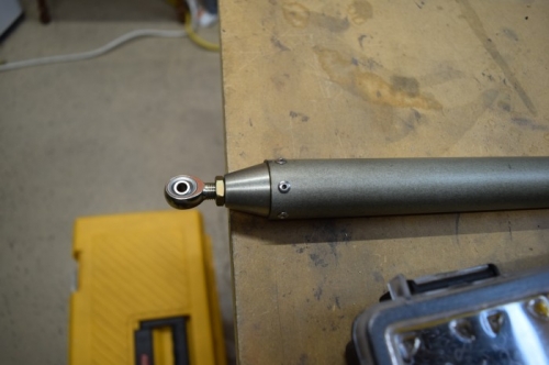

Short Description:  Aileron push rods (22-02)

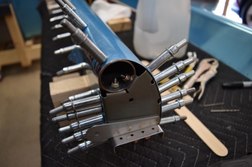

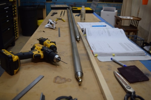

A while ago I cut the tubes to length for the in-wing push rods and prepared the end caps. One of them I wasn’t happy with, so I ordered a new one. Now that I completed the aileron I hopped back on the push rods. I prepped and primed the long tubes and the end caps, then assembled them per the plans.

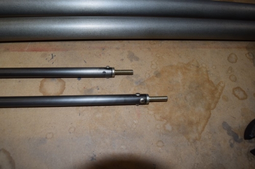

The small rods that reach out to the aileron required a lot more work. Apparently, they used to supply powder coated rods that fit the rod ends, but now they provide a thicker steel tube that requires reaming to size. I had to purchase a couple of different size reamers to get the ID of the tube to the right size. I was slow cutting, but I managed to get them to fit nicely. The next trick was to cut the holes. Some created some printed templates that worked nicely and I used those holes to drill through the rod ends as well. Mark the locations prep and prime. After everything was primed, I added some JB weld to the interior of the rod ends and let that set up for 24 hrs. I was concerned that the long rivets would expand in the tube and not on the outside when I went to squeeze them. Once set, I redrilled the hole through the JB weld so I would have a solid structure for the rivet. Even with all that the shop head still has an oval shape due to the small radius of the tubes.
Aileron long push rod end (26-101)
Both push rods complete (26-102)
Small push rods (26-104)
