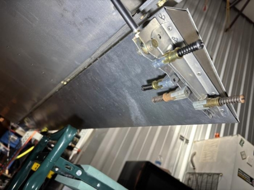

Date:  11-09-2025
Number of Hours:  4.00

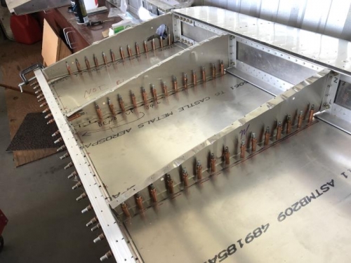

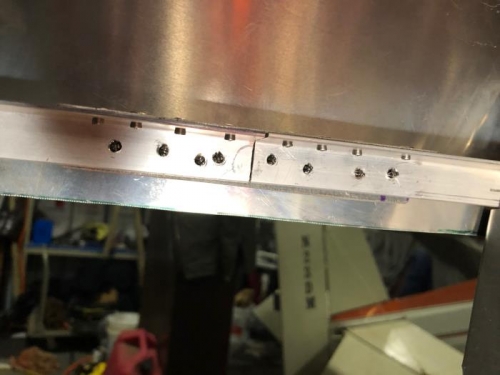

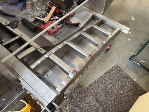

Short Description:  finished installing wing walk stiffeners on left w

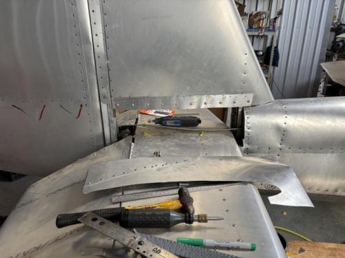

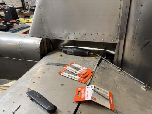

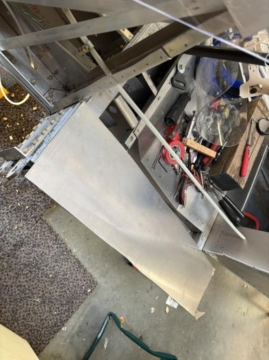

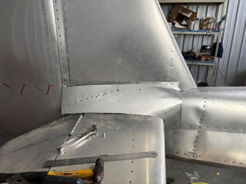

Finally I get a little taste of a little bit of progress. The four stiffeners are installed on the left wing stub. I cut out a piece of 0.032 to use for the skin in that area, but I am putting off installing that, because now I am thinking about how I'm going to anchor the little gap-sealing strip that goes between the wing stub and the wing. I need to install some nut plates to receive the screws that hold that gap-sealing strip in place, and I need to plan for the locations of those nut plates.
