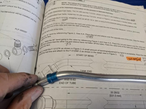

I had used EZ Turn on the fittings into the fuel tank and although there was a time when that was acceptable practice, Van's now says don't use Fuel Lube and EZ Turn is pretty much fuel lube. So I removed the fuel tank and cleaned the outside of that up and polished it a bit, then removed the two fittings and cleaned them, and reinstalled them using Permatex 2.
Unfortunately when I was torquing the fuel line, I put a gash in the line. So I removed it. I'm not sure how I put that initial bend in the line, given that it starts 21/32" from a flared end, but it sure wasn't with a tubing bender. The Van's instructions says to flare the tank end, then bend, then insert the sleeve and nut from the end. Nope, that doesn't work. A sleeve will never fit over a 38 degree bend.
I'm guessing I flared and put the sleeve and nut on, then used spring benders, holding the tank end in place, probably in a vice. We'll see. I had to order new tubing.

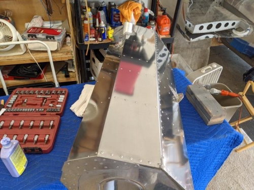

Some aluminum material arrived so I made a new inspection cover for the fuel quickdrain and match drilled the holes, installed the nutplates and called it a day on that lingering project.
