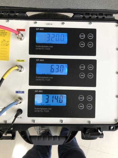

Short Description:  Weight and balance
Weight & Balance
Date 03/13/19
Registration N1960G
Builder :Giorgio Azzalin
Model :Nando Gropppo Trial
Serial#: 00122/163
Datum on the leading edge of the aircraft ( arm measurements taken from this point)
Max Gross weight (lb) 1322.7
CG range (In) 9.4-16.7
Wt. (LB) Arm ( In) Moment In.Lb.
Empty Weight /CG
Right Main Wheel 314 -5.75 -1805.5
Left Main Wheel 320 -5.75 -1840
Tail Wheel 63 170.25 10725.75
Aircraft Empty Weight 697 7080.25
Empty C.G. 10.158
Most Aft Weight /CG
Front Seat (Pilot) 170 0 0
Rear Seat (Passenger) 170 31.4 5338
Baggage 22 52.4 1152.8
Fuel (lb) 156 8.4 1310.4
Weight 1215 14881.45
CG 12.2
