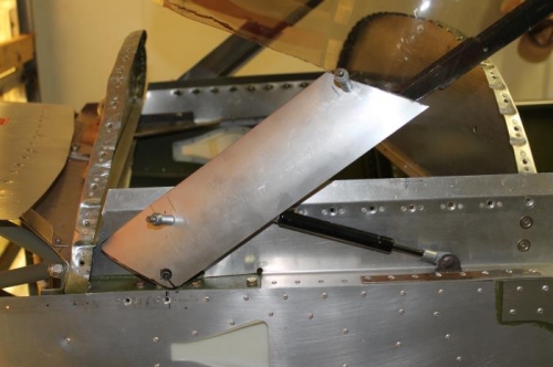

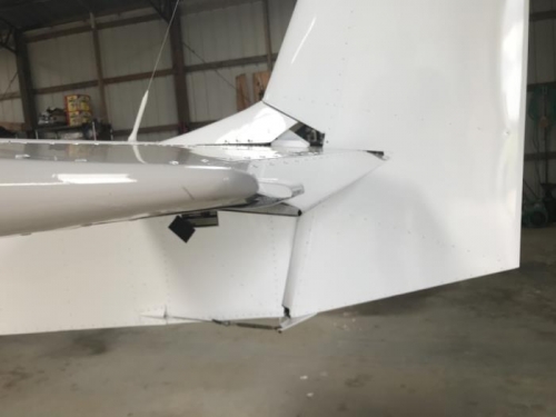

Short Description:  Bungee Style Elevator Balance
Drilled 17/64 hole in horizontal stab at spar
Installed a 3/16 nut plate
Installed a 3/16 eye bolt with lock nut and lock tite
Drilled 3/16 hole in elevator bellcrank
Installed two small s-hooks in hole above

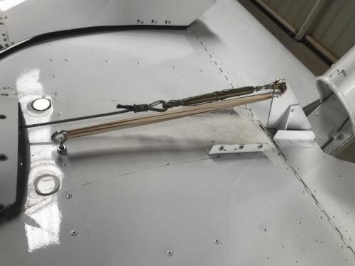

Installed 7 #64 rubber bands between eye bolt and nut plate
Approximately balances elevator.
Photo 1 & 2 self-explanatory
Photo 3 is the amount of trim required for level flight.
