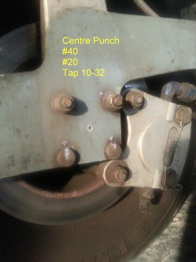

Short Description:  Nigel Charles RV8 Jack Attachment Pt2
Punch and Drill

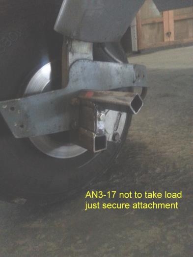

Secure with AN3 bolt

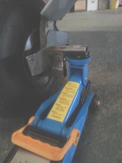

Jack Up
