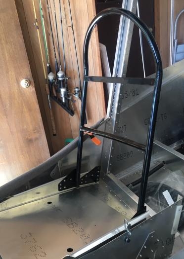

Looked up cotter pin specs for seat back retention. Sized the hole in the seat back stop weldments and reamed to needed size. Installed temporarily.

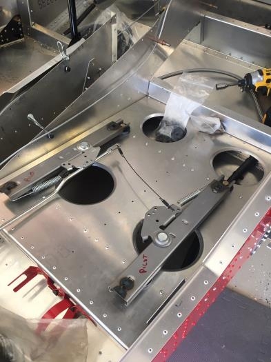

Dug out the seat slider tracks; installed them to the seat bases using the upplied rubber cushions and AN5 hardware. Have not mounted seat pans yet as I will need access to the torque tube tunnel during the tube reinstallation. Debating whether to even use an adjuster on the left since I'll be the only flyer on that side.
