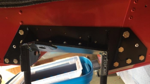

Brief Description:  Install left gear saddle weldment & rivet
Compared to the right side, this side was simple. There was no rivet interference with the nut side of the attachments, so I didn't have to drill-out the rivets that caused the problem on the right side.
Installed all bolts.
Riveted all 4 exterior rivets (the small silver dots on the mount below), two each side.

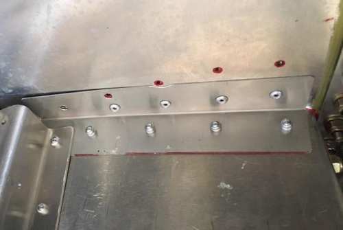

Next, I had to modify my riveter head by grinding it down a bit to fit the tight angle for the gear-channel-to-fuselage side L-angle. See 2nd pic below. The rear-most hole will be filled with a rivet when I install the outboard seat pan angles.
Bolted and riveted
Bolted and riveted
red holes are for the seat pan side supports
