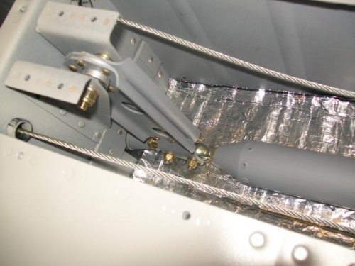

39-6, Step 3
Bolt the F-1063 Elevator Idler Arm Assembly to the F-1063B Idler Arm Brackets using the hardware shown in Figure 3. Bolt the F-1089 Elevator Pushrod Assembly to the elevator idler arm assembly using the hardware shown in Figure 3. Bolt the F-1090 Elevator Pushrod Assembly to the elevator idler arm assembly using the hardware shown in Figure 3. While this sounds easy, I spent about thirty minutes last night attempting to get this installed and accomplishing nothing, then spent another thirty to forty minutes today. Putting those washers in the bottom of the idler arm when you couldn’t see what you’re doing was tough.
39-6 Completed per plans

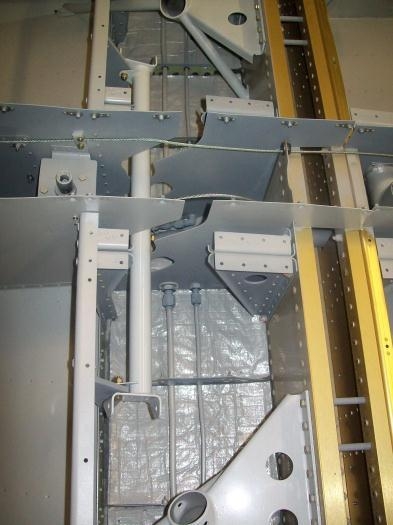

39-7, Step 4
Install the WD-1010 Control Column onto the F-1033-L and F-1033-R Control Column Mounts using the hardware shown in Figure 4. The right side is a mirror image of the left. The control column should rotate freely on the control column mounts.
I also spent some time cleaning up the control sticks and the control stick bases so that they will actually fit together. I decided to wait to drill the hole through the control stick to a time when I’m not so tired. That may be a few days.

Elevator Idler arm installed and connector to the forward and midlle elevator pushrods
Elevator Pushrod Assembly connected to the aft end of the midldle elevator pushrod
Control Column installed
