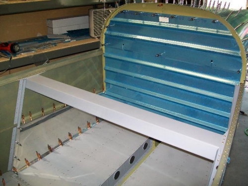

Brief Description: Baggage area continued #3
33-9, Steps 1, 2, 3, 4, 5, & 6
Adjust the aft end of the F-1080 Right Baggage Cover so that it is aligned with the edge of the F-1006F Lower Baggage Bulkhead Corrugation. Match-Drill #30 the holes in the bottom flange of the right baggage cover into the F-1022A-R Baggage Floor, then match-drill #30 the holes in the top flange into the F-1 013-R Fwd Fuse Longeron.
Match-Drill #19 the holes along the right edge of the F-1006F Lower Baggage Bulkhead Corrugation into the aft flange of the F-1080 Right Baggage Cover and into the F-1006C Bulkhead.
Final-Drill #40 the nutplate attachment rivet holes common to the F-1080 Right Baggage Cover and the F-1034C-R Fuselage Bulkhead.
Cleco the F-1006E Upper Baggage Bulkhead Corrugation to the F-1006F Lower Baggage Bulkhead Corrugation.
Match-Drill #19 the holes of the upper baggage bulkhead corrugation into the F-1006A, C, and D Bulkheads.
Remove the F-1006E and Baggage Bulkhead Corrugations and the F-1074 Tailcone Forward Top Skin.
Cleco the #19 hole in the aft flange of the F-1080 Right Baggage Cover. With the top and bottom flanges clecoed in place, match-drill #30 the three remaining 1/8"-holes in the aft flange into the F-1006C Bulkhead.
Rear bulkhead in place
