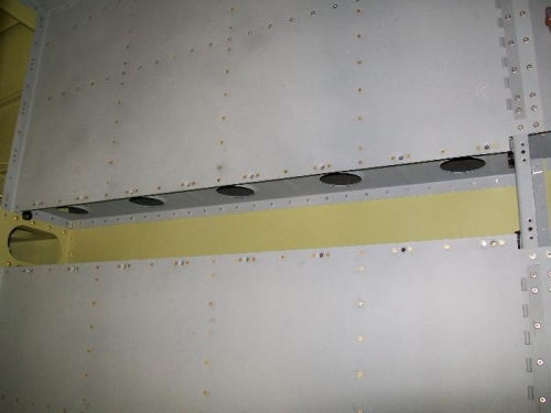

Nutplates and rivets set on the rear flange

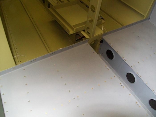

Nutplates and rivets set on the tunnel
