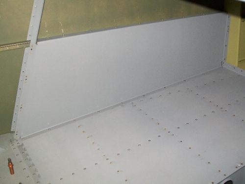

Brief Description:  Baggage area continued #4
33-9, Steps 7, 8, 9, 10, & 11
Match-Drill #40 the nutplate attachment rivet holes, into the F-1006C Bulkhead and into the F-1080 Right Baggage Cover.
Remove the F-1080 Right Baggage Cover and deburr the holes in the baggage cover and all the accessible, corresponding holes in the other parts.
Dimple the #40 nutplate attachment rivet holes in the F-1080 Right Baggage Cover and the corresponding holes in the mating parts.
Scuffed, cleaned, and primed all parts.
Rivet the F-1080 Right Baggage Cover to the F-1013-R Fwd Fuse Longeron, the F-1022A-R Baggage Floor, and the F-1006C Bulkhead.
33-9 Completed per plans.

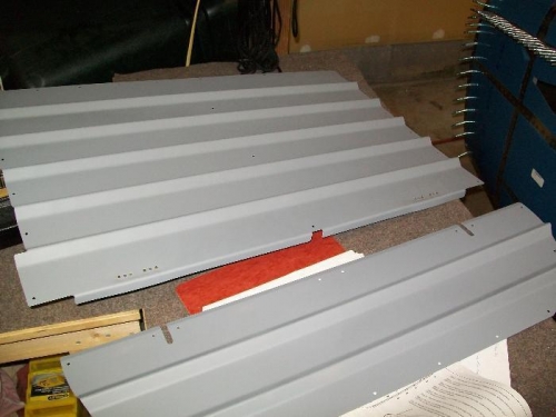

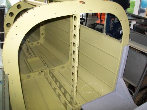

33-10, Steps 1, 2, & 3
Match-Drill #40 the nutplate attachment rivet holes for all the nutplates (21) into the F- 1006A, C, and D Bulkheads and into the F-1028 Baggage Bulkhead Channel. Deburr the holes.
Dimple all of the nutplate attachment rivet holes.
Rivet the nutplates to the F-1006A, C, and D Bulkheads and to the F-1028 Baggage Bulkhead Channel.
Right baggage cover primed and installed
All nutplates installed in the tailcone bulkhead
Baggage bulkheads primed and nutplates installed
