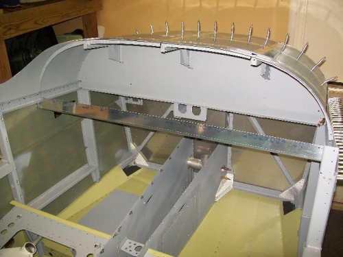

Upper fuselage assembly temporarily installed on fuselage

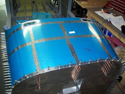

The upper fuselage skin all riveted
