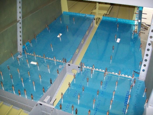

Brief Description: Baggage compartment started
33-2, Steps 5, 6, 7, 8, 9, & 10
Cut two 16" lengths of AN257-P3 and remove the pins. Make the F-10103A-L and -R Lower Seat Hinge Halves using the information given.
Locate the F-10103A-R Right Lower Seat Hinge Half on the F-1022-R Baggage Floor, then Match-Drill the holes of the seat floor into the hinge half using an 1/8" drill. Repeat this step for the F-10103A-L Left Lower Seat Hinge Half and the F-1022-L Baggage Floor.
Cleco the F-1022A-L and -R Baggage Floors to the F-1006B Bulkhead, the F-1023-L and -R Baggage Floor Angles, the F-1019, -1020, and -1021 Baggage Ribs, and the F-1024-L and –R Seat Floors. Cleco the F-10103A Lower Seat Hinge Halves to the baggage floors and the F-1034A Bulkhead.
Final-Drill #40, deburr, and dimple the holes in the vertical flange of the two F-1023B Baggage Floor Angles which are common to the F-1070 Mid Side Skins. Cleco the baggage floor angles to the mid side skins and F-1022A Baggage Floors. Final-Drill #40 all of the 3/32 holes along the inboard edge of the baggage floors common to the F-1019 Inboard Baggage Ribs.
Final-Drill #30 the row of holes along the forward edge of the F-1022A Baggage Floors common to the F-1024 Seat Floors. The holes common to the F-1023B Baggage Floor Angles and the F-1022A Baggage Floors. The row of holes common to both baggage floors and the F-1034A Bulkhead (including the F-10103A Lower Seat Hinge Halves).
33-2 Completed per plans
