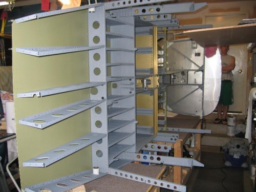

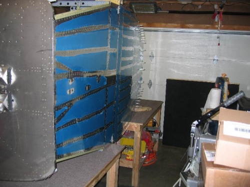

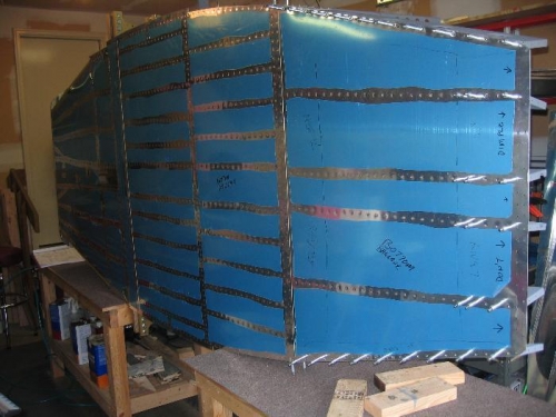

Brief Description:  Rivet the bottom flange of the Aft Center Section
28-14, Step 1
Rivet the bottom flange of the Aft Center Section Bulkhead Assembly to the F-1076 Center Bottom Skin and F-1072 Fwd Fuse Bottom Skin.
This is my second atempt at this task. The first time I attempted to back rivet these two lines of rivets. I wasn't happy with the results, so I drilled about 75% of the rivets out. Brad assisted me with bucking the rivets the old fashion way.
We had to tip the fuselage on it's side to accomplish this step.
28-14 Completed per plans.
