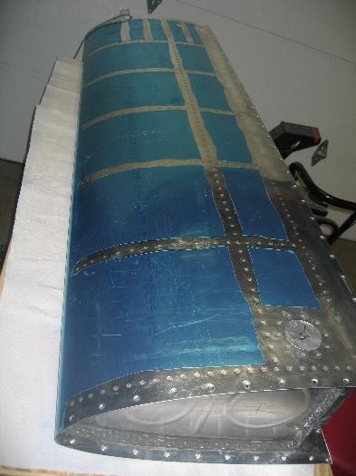

I started with Plan B to validate that there are no leaks in the fuel tanks. I'm testing with water. After about 3 hours, there are no visible leaks. Other than the one I created before I capped the fuel vent. :^( After cleaning that mess, everything appears to be dry.

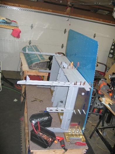

Fluted the lower flange of the outboard seat ribs to match the holes of the center bottom skin. I cleco'd the outboard seat ribs, aft center section bulkhead, inboard seat rib subassemblies, and the rear bulkhead assembly to the center bottom skin.

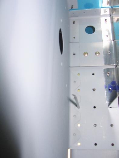

The next step was to match drill, but I have a problem with four holes that aren't in alignment. I have to leave to attend a couple meetings, so it will be tomorrow before I can investigate. Per the illustration Figure 3 on 26-5, it appears that these holes are supposed to be in alignment. They're not, so I have to figure out what is wrong. (See Image 3)
Left fuel tank with 30 gallons of water
Bottom skin, outboard ribs, and the bulkheads cleco'd
My problem area.
