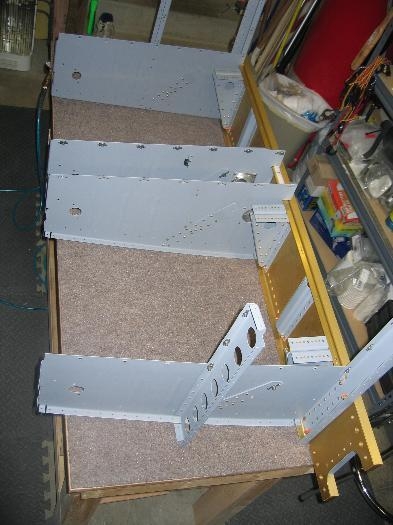

26-4, Steps 1, 2, 3, 4, 5, & 6
Cleco and match drill the flap actuator bracket to the left and right inboard seat ribs, as well as the flap moter attach angles.
Debur, clean, and prime all parts.

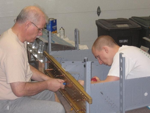

Insert the heat duct tee into the scat tubes flanges on each of the inboard seat ribs. Rivet the nutplates to the flap actuator bracket. Rivet the flap actuator bracket to the inboard seat ribs. Rivet the flap motor attach angle to the flap actuator bracket.
Bolt the inboard and outboard seat ribs to the aft center section bulkhead. Rivet the inboard and outboard seat ribs to the aft center section bulkhead.
Bob & Brad riveting the inboard seat rib to the aft center section bulkhead
This section all completed
