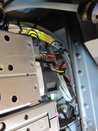

Brief Description:  GTN650 Fan and Final Panel Wiring
I found a way to pull out the center radio stack without taking out all the screws. I pulled the entire panel out about an inch. This gave me enough room to fish out the GNT650 fan pigtail and plug it into the the cooling fan.

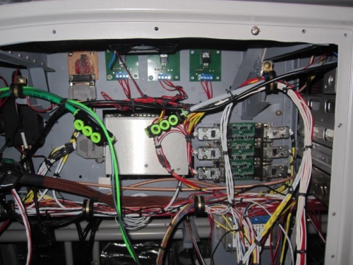

I spent some time finsihing the wiring behind the left panel insert and ran the static and pitot lines.

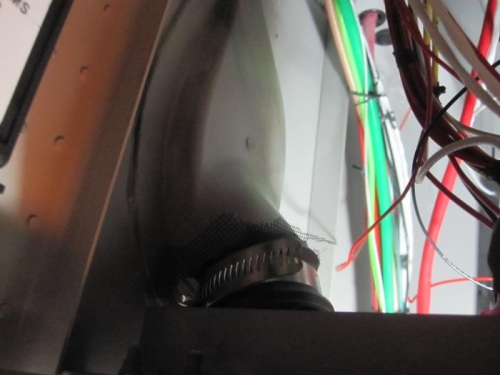

While I had the panel pulled out, I placed some screens over the NACA vents.
