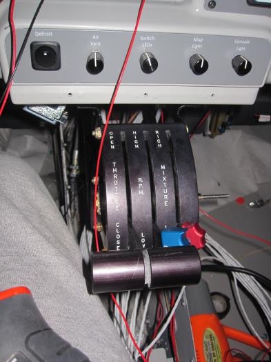

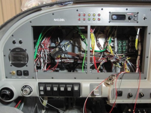

Brief Description:  Left Panel Insert and Throttle Quadrant
Connected the annuciator wiring harness to the annunciator LEDs, annuciator test switch, the low fuel test switch, the overhead lighting switch, and the right seat disconnect switch. Installed the EFIS/Auto Pilot switch. I then hooked up the static lines to the Gemini EFIS, the Auto Pilot, and the alternate air switch. The Pitot line was hooked up to the Gemini EFIS and the Auto Pilot.
I installed the Left Panel Insert into the panel. I then bolted the throttle quadrant to the panel and sub panel.
