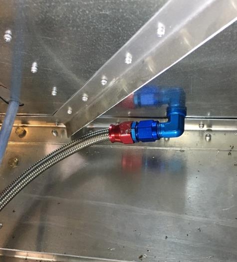

Installed the Speed Seal fitting to the fuel pump-to-bulkhead end of the line. First, used a cutoff wheel to trim the hose length. Like a dolt, I forgot to first place the red half of the fitting on the line. Although I wrapped tape around the line, it still frayed a bit making it a real bear to get it on. Finally had to remove the line completely from the fuse in order to manhandle it. Trimmed up the whiskers a bit and got it on. Then had to install the blue part of the fitting; used the vise to hold things tight. Reinstalled completed line.

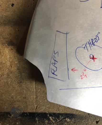

Sanded the upper panel skin a bit, especially at the separate line that will be where red paint meets the flat panel paint. Should be ok.
The panel front was previously digging into the cabin frame, so made multiple attempts to trim the notch up a bit; didn't want to go too radical hence the multiple attempts.
