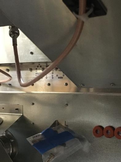

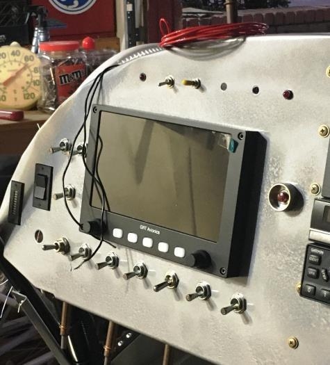

Picked up the 3 remaining breakers today - all 5A, for master solenoid, alternator field, and nav lights. Installed in the panel.

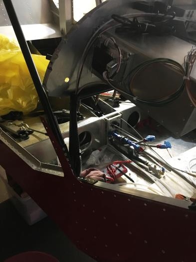

Ran right side fuselage wires thru wire loom and secured as I did on the left side (see yesterday). Installed a BNC connector to the end of the RG400 coax, then attached that to the comm. Checked remaining right side wires to ensure sufficient length to reach the left side of the plane to connect to the switches.
Installed the trim selector switch and keylock safety switch into the console top surface. Sealed the 3 plugs and the elbow fittings for installation into the fuel selector so it can be mounted into the console.
