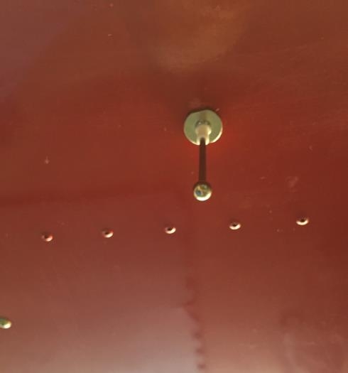

I previously installed the xpnder antenna ahead of the rudder pedals, and was going to install the ADSB antenna under the passenger seat. I was concerned about needing line-of-sight from one antenna to the other, so I called uAvionix.
Their support person siad that the ADSB antenna really should be mounted orthogonally to the ground, but it was less important for the xpnder antenna. So I uninstalled the xpnder antenna and installed the ADSB antenna in the front location. I then drilled a hole and installed the xpnder antenna just forward of the hell hole.
I then decided to tackle a real bear of a job. I had run the coax for the top comm antenna, but one of the mount pads came undone (self stick). It's a real pain getting up in there to re-stick a new pad and remove the old. In doing so, I of course ripped the top horizontal cable pad, so had to drill an L angle and zip-tie the cable to that. I allowed space between the cable and the L angle. Finally was done with this task!
