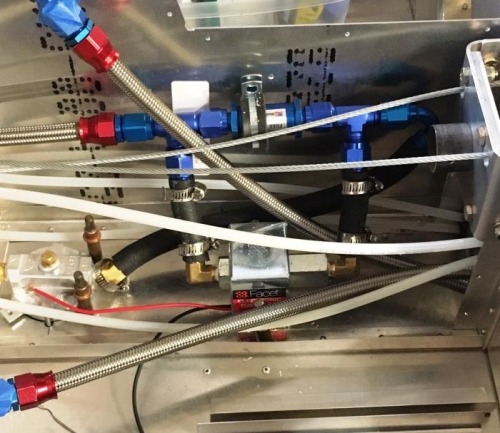

Worked more on the fuel pump / bypass manifold. Cut a length of rubber fuel line and installed witout clamping on each end - from the gascolator to the 120 deg elbow on the manifold. Gauged distances, then drilled-out one rivet for the location for the pump. Drilled the other side and cleco'd.
Installed a SpeedSeal hose end on one end of the remaining braided fuel line to go from the manifold to the ultimate firewall bulkhead connection.

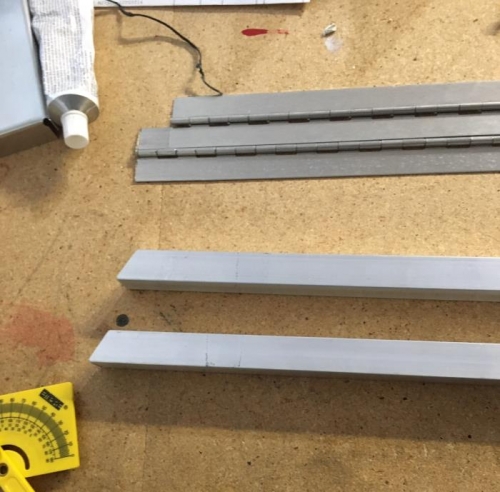

Started working the door frames. Found the upper door frame pieces and measured the required angles, cut, and dressed them. Cut angles for the aft edge as well.
