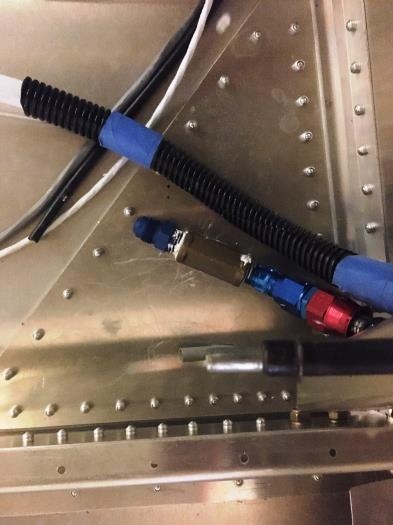

Applied thread sealant to two fittings and installed them into the drain "T" shown in pic 2 below.
Installed the two loomed assemblies into the aft channel of the forward vertical channel and cleco'd into place. Tightened the bulkhead connector nut on the outside. Installed the lower fuel drain thru the fuselage bottom and into the bottom of the "T" fitting.
Installed right side wires into a smaller loom since no pitot static lines on the right side. Installed the right fuel line into its own loom and zip-tied it to the line.

fuel line to drain & wire/pitiot-static

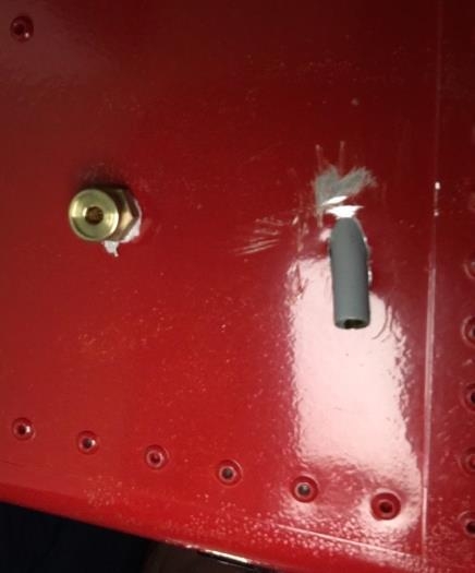

Underside; fuel drain & brake line tube
