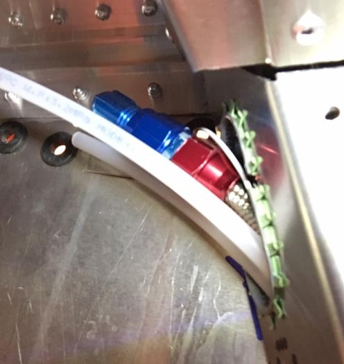

Brief Description:  Trying to run fuel / pitot / lights wires & lines
*sigh* this was/is really frustrating.
Decided to try running the lines in the left side vertical channel. Finally obtained my grommet edging, so nothing holding me back.
First thing was that the pitot lines I purchased are SUPER stiff and want to just flop all over the place.
Trying to first put the line in the channel, then putting it in position was frustrating. Could not get the fitting onto the L fitting already bolted in the fuselage. Plus, the hole in the channel was fine without the edging, but then the fitting wouldn't go thru. Removed everything and enlarged the channel oblong hole. Removed the L fitting from the fuselage and attached to the line in the channel.
I was able to maneuver the entire assembly into position and I think it will work. Before I make any other rash judgements, I'm going to make sure the lower end of the hose can attach to the fuselage bottom fuel drain fitting.
*sigh*
