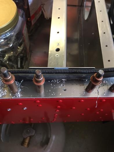

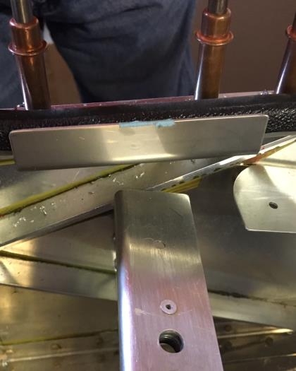

I dug-out the 4 door lock striker plates; a forward and aft for each side. deburred and de-labeled.
Installed the door frame weatherstrip to provide correct spacing for the strikers, which are supposed to rest right up against the strip. Clamped in place and drilled.
Updrilled all holes to #20 for A5 rivets. This includes the previously pilot drilled lower door sill channel.

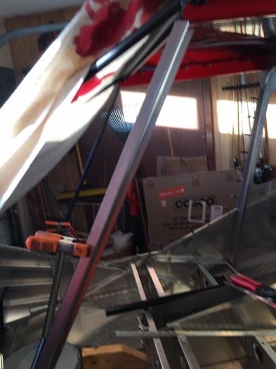

Next was fabrication of the forward vertical door post / weatherstrip channel. These were quite a bit longer than required, and only had 90 deg ends. Since these install on an angle, I had to cut to length and custom-fit the upper and lower "notches" to go around existing frame components.
