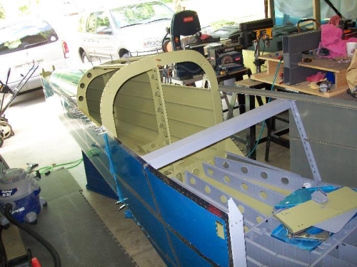

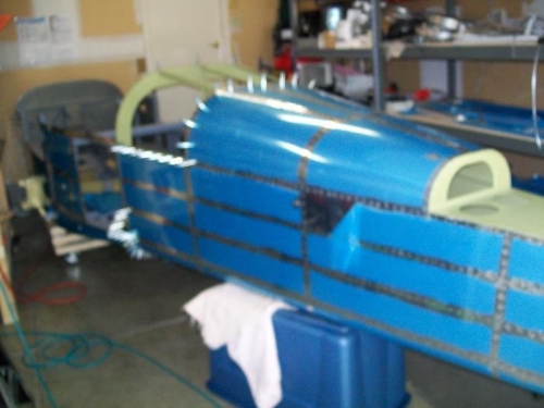

Brief Description: Started riveting tailcone to fuselage
32-5, Steps 11, 12, & 16
Cleco the tailcone to the middle fuselage, then bolt the F-1046 Mid Fuselage Longerons to the F-1032 Tailcone Longerons using the same hardware as before.
Rivet the skins to the F-1006A, B, and C Bulkheads.
Rivet the F-1070-L and -R Middle Side Skins to the F-1046-L and -R Middle Fuselage Longerons respectively.
