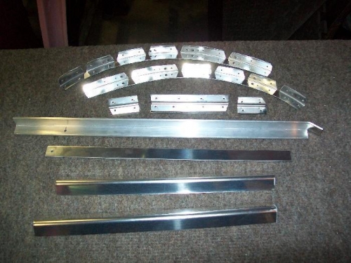

Brief Description:  Started upper fuselage assembly
31-2, Steps 1, 2, 3, 4, & 5
Fabricate the F-1044C Spacer from AS3-063 x .625.
Fabricate the F-10448 Angle from AA6-125 x 3/4 x 3/4.
Fabricate the F-1003D and F-1003E Instrument Panel Attach Flanges from AA3-032 x 3/4 x 3/4.
Break apart the F-1044DEF Angle into individual F-1044D, F-1044E, and F-1044F Angles.
Cut apart the instrument panel attach flange into individual F-1003C-L and F-1003C-R Instrument Panel Attach Flanges. Flute and straighten the flanges of the F-1003C Instrument Panel Attach Flange.
31-2 Completed per plans.
