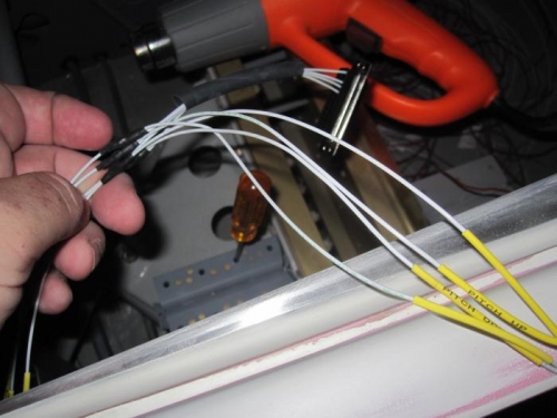

Brief Description:  Stick Wiring & Cleaning Tail Feathers
I started wiring the pilot stick. I'm using a DB-25 so that I can remove the stick if required. The left and right sticks are being wired in parallel, with the exception of the ground. The ground for the right stick will be routed to a switch on the panel to disable the functionality on the right stick.

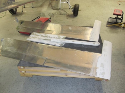

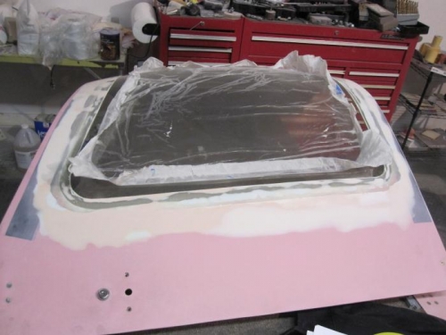

Janice finished cleaning the tail feathers and the left door window.
