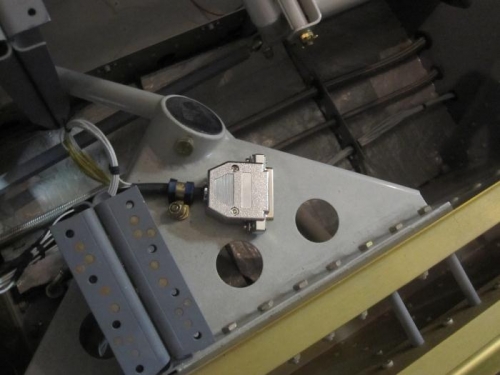

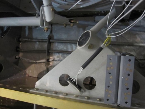

I spent most of the day working on the feeds to the sticks. I finished the pilot side connections. I was missing one line, but determined I ran the PTT line with MIC line through the tunnel. I drilled a hole in the gear mount for an adel clamp and enlarged all the holes in the support pieces for the fuel and brake lines for some plastic bushings. I then tied the lines at multiple places and feed the cable group through all bushings to the other side. This is what took the most time, since I had to pass through six bushings one wire at a time.
I started on the right stick connector. I ran out of heat shrink tubing for the labeler, so I decided it was a good time to stop for the day.
