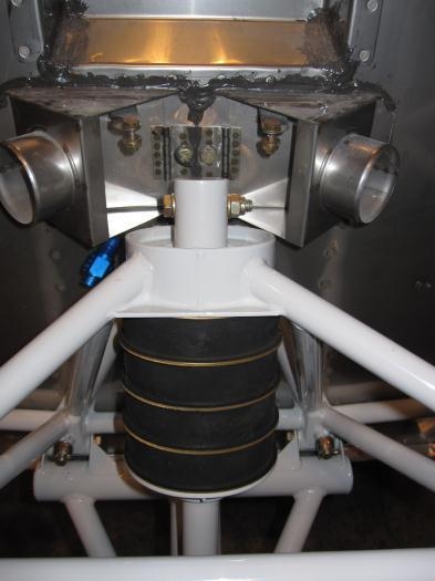

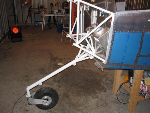

Brad and his roomate Ian, helped me slide the four J-11968-14 Nose Gear Elastomers onto the shaft of the WD-l016 Nose Gear Link Assembly, then slide the shaft into the WD-l001-Dl Engine Mount. Slide the VA-143 Bushing into the nose gear link assembly, then bolt the nose gear link assembly to the WD-l017 Nose Gear Leg. Secure the nut with the cotter pin called-out.

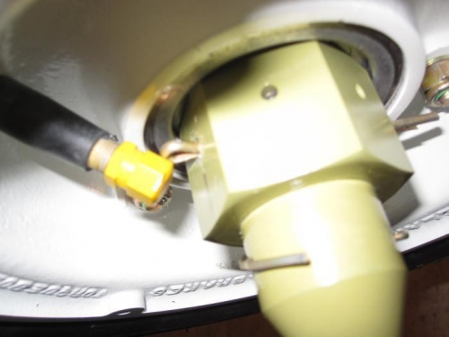

Bolt the U-1004B Nut Extension to the U-1004A Axle Nut. Drill a 05/64 hole through the nut extension and bolt, then install an MS24665-153 cotter pin.
Reinstall the Wheel and Tire Assembly and the U-1004A Axle Nut, then secure the axle nut with an MS24665-360 cotter pin. The cotter pin will have to be bent slightly to clear the wheel while il is being installed.
Unfortunately, the cotter pin doesn't clear the tire valve. I need to determine how best to resolve this issue.
Elastomers Compressed
Nose Gear finished
Cotter pin clearance issue
