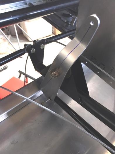

Installed (for the last time hopefully) the AN hardware for the torque tube & elevator control rods. Had to search for some hardware, which took some time. Installed the front AN3 bolt that keeps the torque tube from sliding rearward. Next, installed the spacer and AN3 bolt to attach the Y stick to the torque tube. Next up was installing the elevator control rod to the bottom of the Y stick. This uses a castellated nut. I slid in the cotter pin but did not bend it, as I will have to adjust the fore-aft position of the stick before finalizing.
Next up was installing the elevator bellcrank with AN7 hardware which used a castellated nut. Installed and bent the cotter pin to secure it. Searched and searched for an AN3-13 drilled bolt to secure the elevator control rod. Could not find, so I've ordered another.
