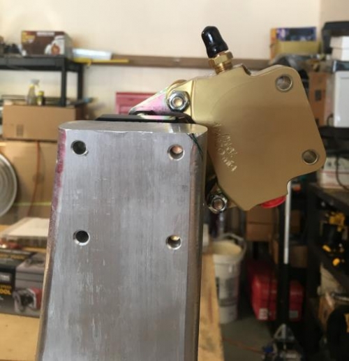

Test-fit the brake calipers. This is a known issue with the 750 MLG. The calipers are of the sliding type, so the caliper cannot be impeded by the leaf. Pic 2 below shows the corner that must be filed-down to allow the caliper to slide. Used a bastard file (technical true name) and filed down each side. Cleaned 'em up with a medium then finer file.
