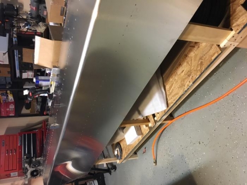

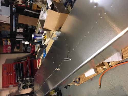

Brief Description:  Skin Lower Side Horiz Stab
Ensured front and rear edges level WRT each other. Screwed blocks of wood to hold aft edge (rear spar) fixed to table; raised front edge to provide clearance due to bowed ribs.
Positioned skin. Deburred. Cleco'd and riveted.
Pictures are rotated to the left; just got lazy and noticed it too late.
