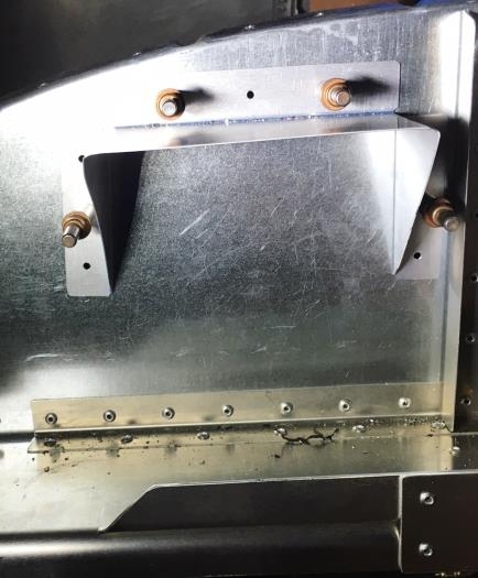

First up was that since I have 2 gps antennas, I really didn't want them sitting on the top of the panel. I fabricated a shelf out of a single piece of scrap alumniium; bent the flanges, drilled pilot holes, and drilled onto firewall. Have not yet riveted.

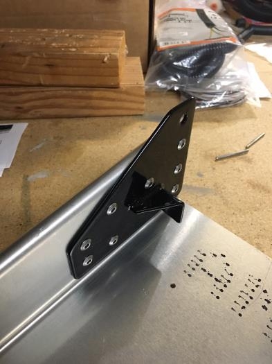

I received my new supply of AS5 (stainless steel) rivets today, so I was able to rivet the seat back stops to the seat pans that will be mounted to the sliding seat mechanisms.

shelf for gps antennae
seat belt stops
seat belt stops
