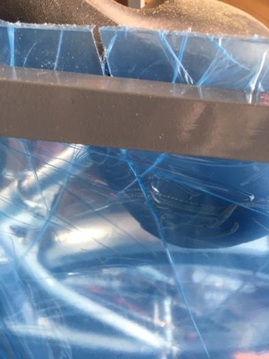

More painting; sanded and re-coated some do-over areas. Painted the four corner gussets for the right door.
Up-drilled rivet holes in left door to hold A5 rivets (aluminum).
Lined up the bubble, and started drilling holes. 3rd hole - pop- cracked the window. $300 fo ra new one. Will wait until I install the right one just so I can order two at once if need be.
