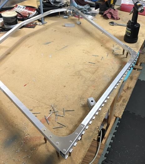

Brief Description:  Initial riveting right door frame
Re-installed lower shims because I removed them prematurely.
Primered other areas on left door frame that were left undone the other day.
Marked and pilot drilled the inner corner braces for the right door. Updrilled to #20. Removed and deburred, then riveted with stainless steel SS5 rivets.
Removed frame from the fuselage and checked its level condition. Was good. Pilot drilled, then updrilled to #20 the inner door corner gussets. Removed and deburred and de-labelled.
Riveted corner gussets.
