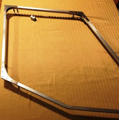

Brief Description:  Rivet left door inner gussets, prep right door
Cleaned up / deburred the inner gussets for the left door;
Drilled, cleco'd, then updrilled to #20 for the A5 rivets spec'd by Zenith. Test fit. Looks pretty good; need to adjust the frame just a bit to get it to lay straight.

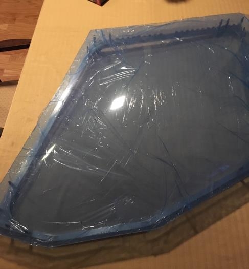

Put the glass in place just to see how much trim will be required.
Will wait to mount the glass window until after I paint both frames.
