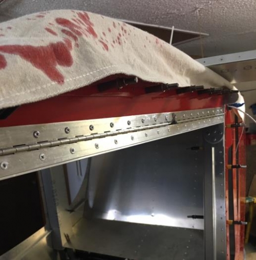

Drilled both left hinge halves. Countersunk door frame side of hinge. Riveted hinge half to upper door frame. Riveted upper half of hinge to the upper door sill.

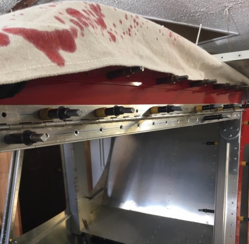

Measured and cut hinge pin; removed 3 center hinge pieces to allow room for the hinge pin insertion. Cut hinge pin in half, measured, and bent the ends to an L shape (see second pic below for installed view).
Adjusted length of right side upper door frame; I'm supposed to allow 5 mm room on each end, and I was tighter than that. Marked rivet positions on the hinge halves. Spaced to allow gusset installation as with the left side.
