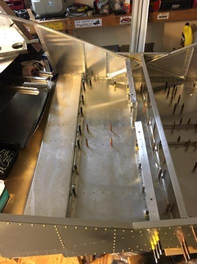

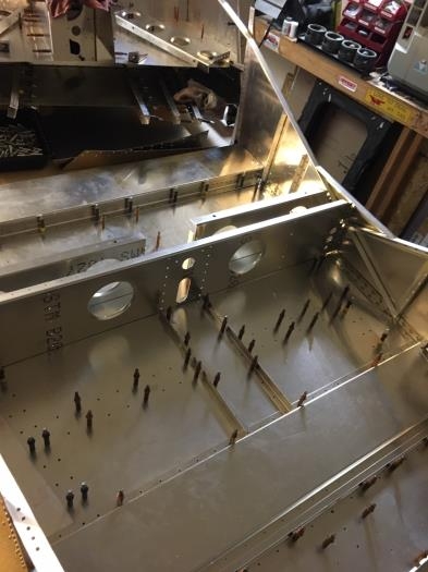

More continued parts cleanup. Started out by riveting the small L-angles onto the outer ends of the forward seat support and the foward sliding seat supports (L&R).
Deburred the gear channel and both side panel assemblies.
Inserted each side panel and cleco'd into position. Held each side vertical by cleco'ing the side panels to the forward seat supports via L-angles.
