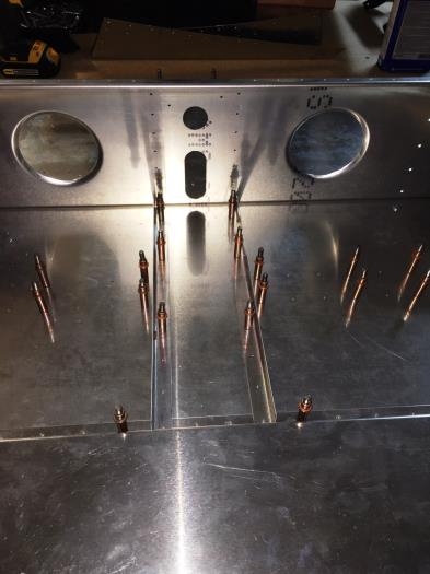

The other day I cut L angles for the lower mounting flange of the center console. Today I drilled them to final size so they can be riveted to the floor without having to remove the rivets later in the assembly.
Disassembled the floor stiffener from the lower skin to allow easier access for back-drilling into the L-angles; my arms couldn't reach to hold them with the stiffener in place. Test fit the torque tube thrust bearing thick angles to ensure there was no interference with the lower angles. Had to trim a bit from the angles.
Disassembled the heal rest channel to debur the left and right gussets that connect the heel rest to the fwd side skins & stiffeners
Removed the front seat support and up-drilled the L-angles that attach the support to the pre-fabricated fuselage side panels.
fwd fuse floor looking aft
