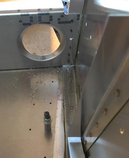

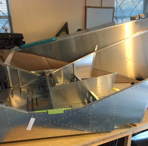

As with the right side, spent a lot of time aligning, calibrating the level, etc to install the left side of the forward fuselage skin (preassembled by Zenith).
Once levelled, I backdrilled from the rear sliding seat option support to the vertical channel of the fuselage side.
Still have to alisgn and cleco the front portion to the large primary front seat support.
both sides on

left outboard rear seat support cleco'd to side
