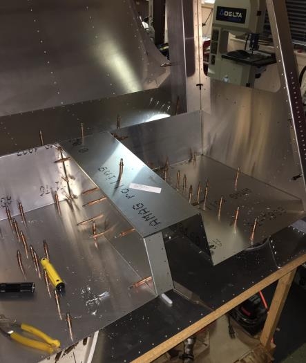

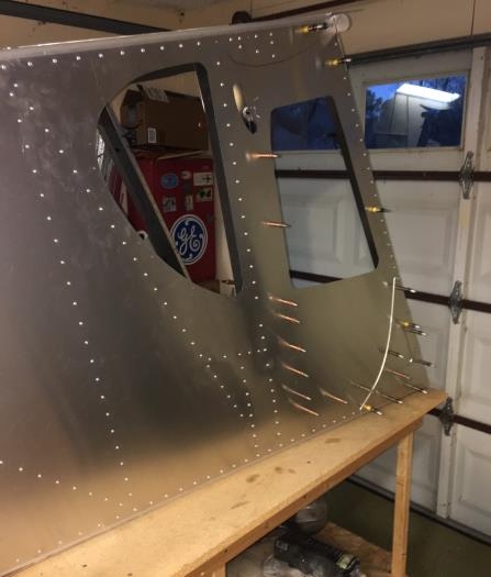

I was conservative in prior entries, not riveting some of the #20 holes because I wasn't sure if they'd be needed at some point in future assemblies. After review of plans and guides, I discovered I could rivet more than I had earlier. Riveted both sides for those parts that can be considered finally installed.
Deburred and de-labelled some parts.
Vacuumed-out FOD from fuselage created from hole drilling during fitment of panels. Added washers to rod-end bearings installed yesterday; saw in builder guide photos they should be there.

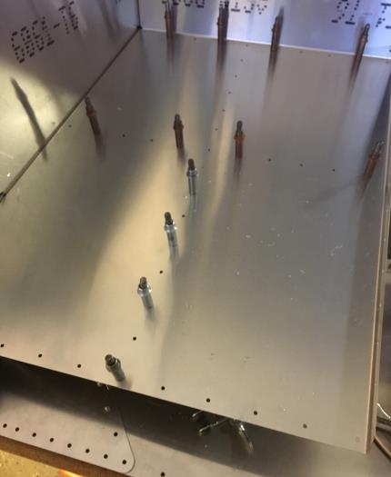

Drilled pilot holes for L-angle stiffeners that go on the lower baggage floor. Up-drilled to #30. Removed and deburred. Re-installed.
Installed the torque tube bearing support and control tunnel sides and top.
Drilling L-angle baggage floor stiffeners
Remaining aft fuselage baggage panels trial-fit
Riveted as much as I could before final assy
