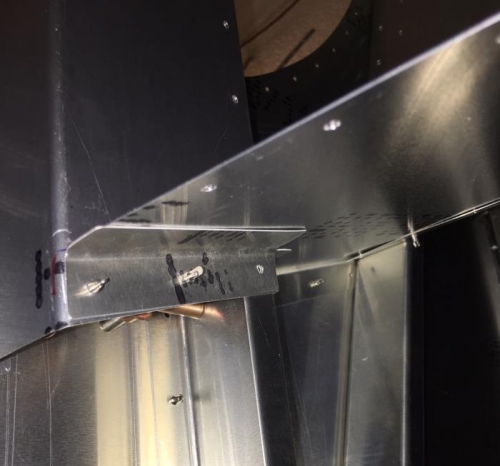

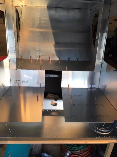

Cleco'd the fwd lower baggage floor in place to the fuse sides and the torque tube x-member and to the baggage uprights.
Cut the 4 L-angles to stiffen the lower baggage floor. Deburred.
Disassembled all. Cut L-angles for the rear and side of the flaperon control covers to provide stability for the upper baggage floor. Drilled and cleco'd the two for the right side.
Faggage floor installaed
underside baggage shelf - L-angle
