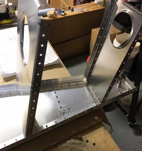

Riveted all diagonal and vertical stiffeners on top skin EXCEPT the front-most angle. Plans show it backwards just like the other 3 panels, but when checking, some builders said to leave it with the vertical part of the angle facing foward - this will match nicely with the upper flaperon rod cover. Will check with Zenith Monday.

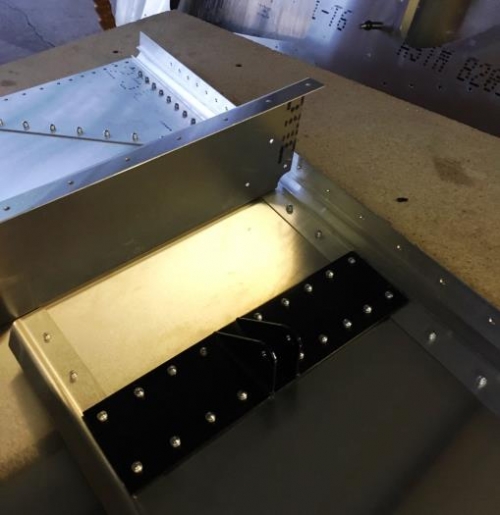

Put the top aside for now and moved the bottom panel to the bench. Riveted the flaperon drive motor bracket back in place. I previously welded it, but realized I hadn't painted it yet. This was just the correction.
Also riveted the two horizontal taill support to the bottom fuselage. These will be used to support the side panels when they are installed (the next task!).
horizontal tail brackets
