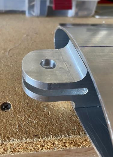

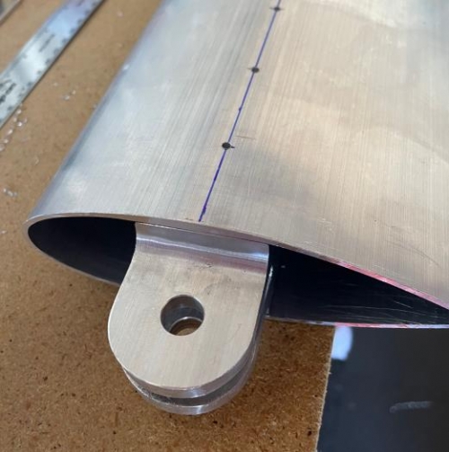

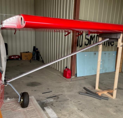

Next, I clamped the lower strut brackets into the struts and drilled thru the bracket. A few days ago, I pilot drilled the struts themselves, but didn't have a clamp that would keep the bracket from moving around in the strut. Applied the clamp and drilled the 3/32, 1/8, 5/32, 3/16, and 1/4" holes thru the struts and inner brackets. Added AN4-21A bolts and torqued them to spec. Placed the left strut in place just for grins. Removed. I will have to make a first cut to reduce the length of the strut because right now it's banging on the underside of the wing where I can't get close to marking the required length.
Lastly, finally got the dihedral set just right, 1.4 deg. The wingtips are an equal amount off the floor, so I'm good with it.
